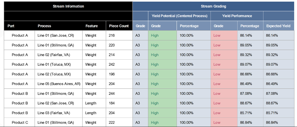

Going after the ‘A3’
Based on Enact’s grading system, a grade of A1 indicates the highest-level performance, with minimal or no scrap. It’s right on target. A C3 grade reveals a process that has low potential and even lower performance. C3 is where you want to deploy your quality improvement teams to resolve systemic issues.
However, a grade of A3 reveals a stream that is highly capable but way off center. There’s a lot of room for easy improvement here. The “3” tells us we have a poor yield, but the “A” tells us that we should have the potential to perform at 100-percent yield by simply retargeting the process.
Often the fix is a matter of operator training or modifying the process setup. But we wouldn’t have been able to quickly isolate the opportunity here without quality performance grading.
In this way, grading is a great tool for quality professionals who not only need to uncover hidden insights in data, but also require an agile way to prioritize their resources and efforts. If you are trying to maximize every resource and make the biggest impact for the least amount of effort, going after the A3 grades will be your best bet for quick returns.

You can create a grading matrix that summarizes all the streams that meet each grade. You can drill down into the streams under different grades. For instance, you can see which ones are A3s, which are where your easy wins are going to be. You can see where your C3s are, which are going to be your major improvement initiatives. The primary benefit of this view is you can target streams based on amount of effort.
A site summary shows the site grade for each critical feature across multiple plants.
Color codes make it even easier to spot areas that need attention. You can click a grade to see layered details that reveal the grades for individual processes or parts. A site summary is especially helpful for determining:
