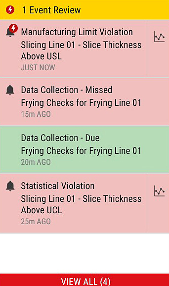

Similarly, figure 2 shows a collection of notifications that are relevant to the current user, including a specification limit violation, a statistical violation, and both a due and missed timed-data collection. This type of chart is nothing new, Weisbrod says, but it can be invaluable when used in a specific and strategic way: “Set up your rules in the system, and let the system tell you when to take action,” he says. These notifications are the starting point for further investigation. Additional actions such as adding comments, selecting assignable causes, taking images, and viewing relevant control charts can all be accessed from these notifications. “This can work at all levels of an organization but tends to be a site-focused solution,” he says. The goal is to reveal meaningful insights in the data, a focus that gets to the heart of quality intelligence.
Figure 2: Notifications provide users with quick access to relevant issues.
Notifications are an excellent way to address specific issues, but how can an organization be more proactive with the quality data it collects? Which sites are performing the best? Where are there opportunities for easy wins? Where are the areas that need the most help? It’s for this reason—to prioritize resources and activities—that Enact includes a data-stream grading feature.
