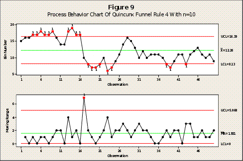

The lesson on tampering can be extended to demonstrate the four rules of W. Edwards Deming’s famous Funnel Experiment. Figures 7, 8, and 9 are process behavior charts demonstrating Rules 2, 3, and 4, respectively with n=10. Figure 3 demonstrates Rule 1. It is instructive to note the change in the control limits from those generated by Rule 1 as Rules 2 and 3 are invoked. The process behavior chart for Rule 4 shows a complete lack of statistical control.

Figure 9: Process behavior chart of Quincunx funnel rule 4 with n=10

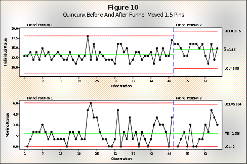

With the funnel held stationary and n=10, have students drop 50 beads and construct an XmR chart of the numbered bins that the beads fall into. Note the upper and lower control limits and discuss the sources of variation. Next, move the funnel 1.5 pins to the left or right and take 10 more data points. The control chart will quickly show one or more signals of lack of control against the original control limits as seen in Figure 10. This demonstration may also be performed with an X-R bar chart, but this, of course, requires more class time.
Figure 10: Quincunx before and after funnel moved 1.5 pins.
