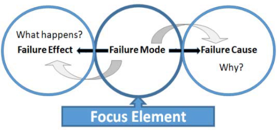

The failure analysis step described in the AIAG & VDA FMEA Handbook is significantly different from the analysis of failure described in the AIAG FMEA Guidebook, fourth edition. (See figure 1.) The handbook instead promotes the use of a “failure chain” of the failure mode at the focus level, the effect of failure at the next higher level, and the cause of failure at the next lower level.
Figure 1: Failure analysis step from the AIAG & VDA FMEA Handbook, first edition, 2019

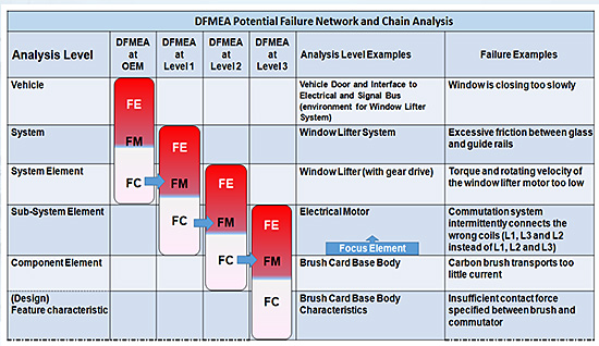

Additionally, the handbook illustrates the relationship among different levels of product: system, subsystem, components, and feature characteristics, failure effects, failure modes, and failure causes cascade from one product level to the next. (See figure 2 below.)
Figure 2: Relationship among different levels of product, from the AIAG & VDA FMEA Handbook, first edition, 2019
