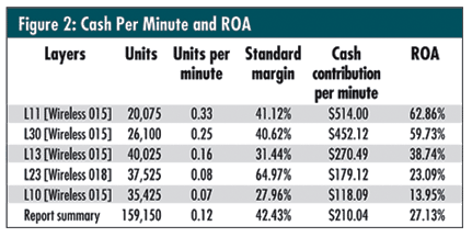

Let's look at a practical example. Figure 2, below, shows several products sold into the wireless market. The five products are ranked by cash contribution per minute (analogous to profit per minute).
Notice that ranking by this metric also ranks the products by ROA. So, in effect, cash per minute is the operational equivalent of ROA. It is important to emphasize using cash per minute because a profitability metric makes it possible for the first time to use ROA at the operational level. For the first time, there is a match between the key operational metric and the one of most interest to shareholders, ROA.
The second major point to emphasize from this table is that there is no correlation between margin and cash per minute. The product ranked fourth by cash per minute actually has the highest margin. But its cash per minute and ROA are substantially lower than the three products ranked above it.

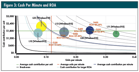

The conclusions drawn from the data shown in figure 2 are even more dramatic when presented in figure 3.
Plotting cash per unit vs. units per minute generates topographical contour lines that represent equal amounts of cash per minute. Just like the elevation contours of a geographical contour map, the contours of this "profit topo" map increase in both cash per minute and ROA by moving to the upper right of the chart. It is easily seen that the product represented by the green bubble on the right-hand side of the chart is the most profitable from a profit-per-minute perspective. Similarly, it is apparent that the product represented by the yellow bubble on the upper left, while having the highest margin, is actually below the average cash per minute indicated by the blue contour line.
