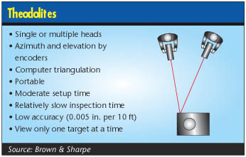

Theodolites
Theodolites use optical sensors and encoders to map data points and record the position of a part. They typically contain an electronic system capable of triangulating targets in relation to the part, but this type of system doesn’t scan the part. Theodolites are a good choice when accuracy is more of a concern than speed.
The principle behind the theodolite is similar to that of the laser tracker in that it uses motorized devices to develop the horizontal and vertical readings, the angle readings, and the distance readings from the beam that it emits.
Walter Pettigrew of Carl Zeiss IMT Corp. explains how this technology works. “Let’s say you have three optical devices, and you point all three of them at a spot on the part,” he suggests. “You can triangulate and locate that feature. Then, if you focus it on another feature, you can relate the distance between them--much like surveyors on a construction site. You first have to establish three locations and get the distances between them. With basic geometry and trigonometry, you can calculate the part’s position.”
