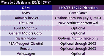

At an Automotive Industry Action Group-sponsored seminar on April 24, the Big Three automakers stood before their leading suppliers and stated the direction that their joint quality system capability assessment initiatives would take: ISO/TS 16949:2002 has been released, and QS-9000 is no longer in the long-term picture.
“We have no plans to revise QS-9000 based on ISO 9001:2000 because we believe ISO/TS 16949 comprehends QS-9000 and includes strengthening major areas,” said Joe Bransky of General Motors Corp. “ISO/TS 16949 contains 90 percent of QS-9000 already, and it’s an improved standard.”
“DaimlerChrysler has already registered some of its own sites to ISO/TS 16949,” added Hank Gryn of DaimlerChrysler. “That’s a big signal which way we’re going.”
“Ford will be going to ISO/TS 16949 by 2006 at the latest,” said Ford Motor Co.’s Russ Hopkins. “We’re working on an announcement that will be forthcoming very soon.”

To be sure the release of ISO/TS 16949:2002 will have a direct impact on manufacturing suppliers to DaimlerChrysler, Ford and GM, several key changes have been made in the latest ISO/TS 16949 version.
For example, the document states it’s an automotive requirements technical specification and is “applicable to sites of the organization where customer-specified parts for production and/or service are manufactured.” A site is defined as a location at which value-added manufacturing processes occur. It’s important to note the document’s definition of manufacturing, which is “the process of making or fabricating production materials, production or service parts, assemblies, or heat treating, welding, painting, plating or other finishing services.” Simply put, this means that not all supplier organizations may qualify for ISO/TS 16949:2002 certification—even if they were certified to QS-9000. In many cases QS-9000 certificates were issued to nonautomotive suppliers or suppliers not fitting the applicability requirements.
Supplier applicability means the company is a direct supplier to a subscribing customer (a manufacturing site of parts or materials) and adds manufacturing value. Sites that offer supporting functions such as design centers, corporate headquarters and distribution centers cannot obtain stand-alone certification to ISO/TS 16949:2002. In addition, there are no planned supplements to ISO/TS 16949 for tooling and equipment and semiconductor suppliers.
On the other hand, OEM assembly centers can be registered to ISO/TS 16949, just like a supplier. “OEMs will be doing the same thing they’re asking suppliers to do regarding ISO/TS 16949 registration,” says IAOB’s Harold Hodder. “And that’s good news.”

IATF OEM options
The current options for IATF OEMs and others who subscribe to ISO/TS 16949 are:
Compliance. Certification is not required but must conform to the requirements.
Optional with upgrade urged. The current policy of Ford and GM
Phase-in. Start with a lead, major-commodity supplier organizations, and the rest will follow.
Mandate. Establish a deadline for first-tier suppliers that fall under applicability.
It’s not necessary for QS-9000-certified organizations that are adding ISO/TS 16949 certification to retain their QS-9000 certification unless customer requirements dictate otherwise.
