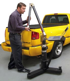

Articulating arms
The most recognizable of portable 3-D measurement devices are the articulating arm coordinate measuring machines (CMM) manufactured by such companies as FARO Technologies Inc. and Romer Inc. (a Hexagon Metrology company).
These are manually operated instruments consisting of an up to 7 ft "arm" (a roughly 14 ft measuring envelope) that pivots at the wrist, elbow, shoulder and base, allowing a probe or laser scanner at the end of the arm to reach almost anywhere on the part being measured. Encoders at the pivot points report the angle of each joint and thus the location of the probe tip in 3-D space. The entire arm and base can be easily moved to anywhere on the shop floor and set up in minutes. It's also possible to position the entire instrument at multiple locations (i.e., "leap-frog") around a very large part and stitch together the data collected from multiple setups to extend the measurement volume.
A disadvantage of arms is that they require an operator to move the probe to each location on the part to take a measurement.
The accuracy of arms has increased tremendously over the years. The most accurate FaroArm has a published single-point accuracy of 5 µm; Romer's will measure to 4 µm in the single-point sphere test.

"We attribute a portion of the GDS audit success to the extremely good body fits on the Grand Am and the Alero," says plant manager Jim Zubkus. "The portable CMM allows us to qualify the tooling in the body-weld-assembly systems better then ever before."
A Romer portable CMM frees Lansing's dimensional integrity team--the engineers and skilled tradespeople responsible for the fit of the body sheet metal--from the tedious guesswork of indirect measurement. The teams are no longer shackled to the traditional stationary CMM--huge and accurate but slow and expensive.
"Before, we verified the tools by carrying sample panels or subassemblies to the CMM room and measuring the product," Zubkus explains. "Now we measure the tools right where they sit in the production system.
