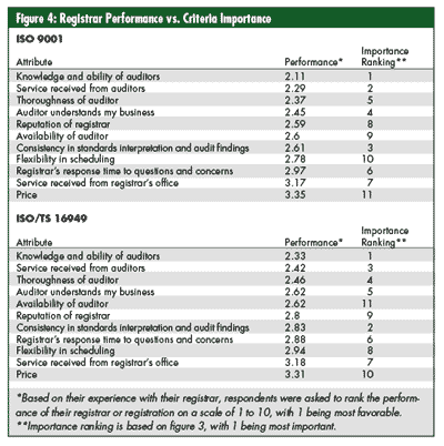

For the past two years, registrars have consistently scored well on the five criteria that respondents say are important, with one exception: consistency in standards interpretation and audit findings. Even though this item is third in terms of importance to respondents, it ranks seventh in registrar performance for ISO 9001.

Along with standards interpretation, registrar response time to questions and registrar service also ranked fairly low in performance.
What all this seems to imply is that although the registrars are doing a terrific job in hiring, training and deploying auditors that know the client's business and can deliver good audits, the registrars themselves have some weak points at the home office. That's where more effort could be expended.

Respondents tell us that price ranks only eleventh in importance when dealing with a registrar, behind a registrar's reputation, auditor availability and flexible scheduling. And yet, when asked what would cause them to change registrars, 25 percent gave price as a reason.
Without digging further it's hard to say what this means. Our guess is that respondents are telling us that price isn't necessarily an important reason for selecting a registrar, but all else being equal, it might be the determining factor. In relation to Cochran's article, this might mean that you first narrow your selection to the registrars that meet all criteria except for price. Price then becomes a bargaining point.
