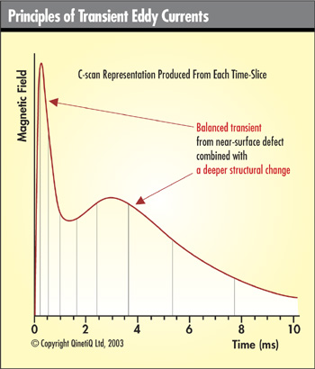

A new technology, pulsed (or transient) eddy current, uses a shaped waveform rather than a continuous sine wave to excite the coil and generate an eddy current pulse in the structure. Because a pulse represents the sum of sine waves for a broad band of frequencies, one test pulse can contain all the frequencies needed to perform the tests at different depths, explains Marcus Johnson, associate scientist with the Center for Nondestructive Evaluation at Iowa State University. “The real advantage is that pulsed eddy current is rich in low-frequency components so you’re able to see near-surface and deeper flaws at the same time,” he notes.
Iowa State’s pulsed eddy current probe is excited by a pulse, which generates a broadband eddy current field in the sample. The higher-frequency eddy current components are generated more quickly within the material under test and lead to a rapid, high-amplitude response, as seen by the probe, says Johnson.
If you look at the pulsed eddy current response as a function of time, the waveform’s earlier portion corresponds to near-surface artifacts such as liftoff. The middle portion corresponds to midsample artifacts such as internal cracks or interlayer corrosion, and the tail end of the waveform could indicate overall thickness or show bottom surface artifacts such as corrosion, as illustrated below.
