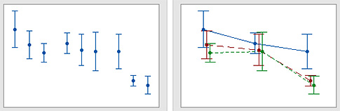

For interval plots, consider the space between groups on the x-axis

When you make an interval plot in Minitab, minding the gap means giving thoughtful consideration to the space between groups on the x-axis. For interval plots, minding the gap can make the difference between these two very different views of your data:
