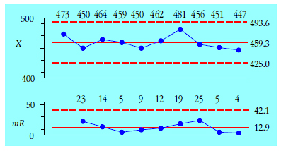

For our first example we will use the residual viscosities from a distillation column. The first 10 values, in units of stokes, are 473, 450, 464, 459, 450, 462, 481, 456, 451, and 447. The average is 459.3 and the average moving range is 12.89. The XmR chart for these data is shown in figure 1. These 10 values are reasonably homogeneous and contain no apparent signals of a change in the operation of the distillation column.
Figure 1: XmR chart for residual viscosities for periods 1 to 10
Since autocorrelation is concerned with pairs of points we begin by using these 10 successive values to define nine pairs of points:
