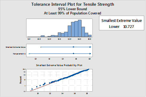

Figure 2: Tolerance interval plot generated with Minitab Statistical Software.
Although percentiles estimate the percent of observations that fall below a certain value, tolerance intervals provide a range that you can be confident a certain percentage will fall between.
They are very useful for determining where a certain percentage of the population will fall relative to your specification limits.
For example, a medical device company I was working with needed to show 95/99 reliability on the tensile strength of plastic tubing. The specific requirement was that it needed to be 95-percent confident that the tubing would withstand 3 lbs of force for 99 percent of product.
Like the hospital data, these data were non-normal. Because a tolerance interval estimates what is going on in the tails of the distribution—not the mean—the distribution assumption is important. Here, an extreme value distribution provided a good distribution fit. Because the tubing could not be too strong, a one-sided tolerance limit, a lower bound, was appropriate. The value of the 99-percent lower tolerance bound with 95-percent confidence was 10.7 lbs. In other words, we could be 95-percent confident that 99 percent of the tubing population has a tensile strength of at least 10.7 lbs—well above the specification limit of e lbs.
