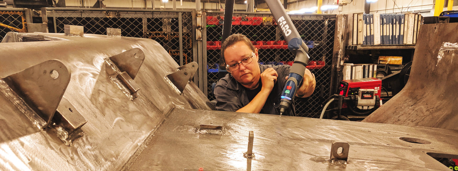

PNA chose a 4 m QuantumS ScanArm outfitted with a FAROBlu Laser Line Probe HD high-definition camera as a main weapon in its inspection arsenal. The FAROBlu uses the most advanced complementary metal-oxide semiconductor (CMOS) technology to deliver fast frame rate (the number of times per second that the camera gathers new data on the part being scanned) of up to 600 frames per second.
“The QuantumS is so much more efficient,” says Foley. “I seldom have to leapfrog with it. I can either reach all the features that I need to on the part, or only have to move it once, which significantly reduces both time and the risk of measurement errors.”
In some situations, dimensional measurements are being made while the part is still on the brake press.
“Especially when we’re doing prototypes and first-offs, having Christine there verifying and working with engineering to make the corrections in real-time drastically reduces the time to get that bend correct,” says Bellitto. “Most of our layout work is done near our brake machines on purpose. The flexibility and mobility of the QuantumS is a real asset.”

“We have a laptop that’s connected to our scanner via wi-fi, so I do everything cordless when I go out on the floor,” says Foley. “I just wheel it out to the area where the larger parts are. It's nice. In fact, I had to explain this to some of our upper management team, because they were insisting that we needed a fixed CMM. I said, ‘Why would I waste the real estate for a fixed-CMM enclosure when I can take the QuantumS out to the part and get sufficiently accurate measurements there?’”
“In our manufacturing processes, we have quite a bit of material movement through our facility,” says Bellitto. “The ability to inspect out on the floor significantly reduces that issue.”
