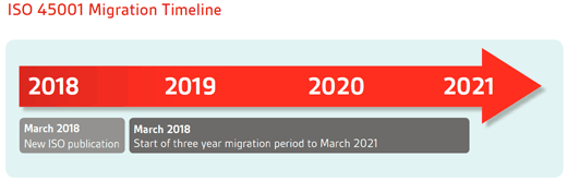

Since the publication of ISO 45001, OHSAS 18001 has been withdrawn and there will be a three-year period of migration allowed for organizations already certified to OHSAS 18001 to upgrade their OH&S management system. (Click here for a clause-level comparison of the two standards.)
