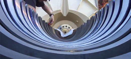

“On a particular job at a shipyard in Spain, the azimuth thrusters were being upgraded, and during the replacement of the drives, the slewing bearings had to be changed out,” says Josefsberg. “We used the Vantage laser tracker to measure the inside and outside diameter of the bearings and map out the casing. We had to ensure that the new bearing was going to fit in the original casing. We were also looking to see if there was any distortion or deformation in the casing or in the bearing.”
FARO_Vantage
The CAM2 software’s simplified analysis and visual reporting allow users to create a coordinate system that is common to multiple elements. Users can quickly scan free-form parts and check their quality in real-time. The software provides immediate feedback with different colors to show deviations from the CAD model during the scanning process. This support easy and prompt identification of inconsistencies.
“We found a problematic area that required machining; the bearing was positioned on a vertical lathe,” explains Josefsberg. “We used the laser tracker to precisely position the lathe’s cutting tool in relation to the bearing. During machining, we would take measurements after each cut to make sure the desired dimension was being achieved. It’s a common practice to use a dial indicator for this kind of work, but we're using the tracker because it’s just more accurate and faster.”
“The client was very happy with the results,” says Josefsberg. “The combination of ACQUIP technical competency and the FARO Vantage with CAM2 reporting provided the client with peace of mind. They had confidence in the results. The client mentioned how fast and accurate the service was. They found the process easy to understand, and that aided the communication with their client.”
