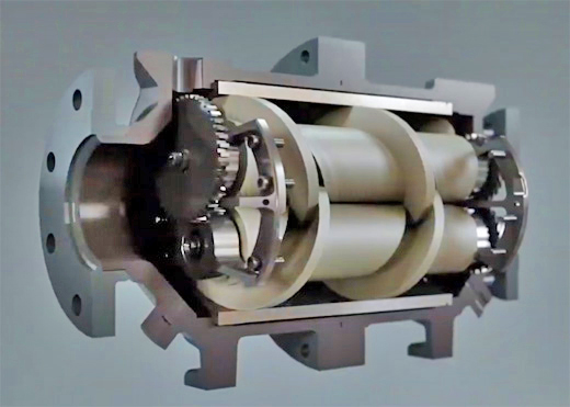

Brodie products involve components with complex shapes and assembly that made inspection measurements a serious challenge when using the traditional tools of their industry, which included height gauges, calipers, dial indicators, and a fixed coordinate measuring machine (CMM).
“We were using a fixed CMM,” says Tommy Rogers, quality manager at Brodie International. “Our older model CMM is good for measuring things like linear dimensions, hole patterns, tapers, circles, and geometry. But when it comes to measuring a compound curve like a helical shape, we were very limited.”
3D image-laser-scanning
Much of the QC oversight depended on proofing a product after final assembly.
“Previously, verification that the helical-shaped rotors were machined correctly was unknown until we actually did the proving of the meter,” explains Rogers. “We measure performance of our meters based on what’s indicated going through the meter vs. the volume measured by the prover. The volume measured by the prover verifies that the meter is measuring correctly.”
