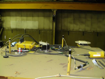

iGPS setup
The iGPS consists of infrared transmitters mounted at fixed locations, various sensors— handheld and mountable on the linkage—to measure the location of a point in space, wireless data transmitters to transmit position data from the sensors to a laptop server in real time, and either standard or custom software running on the laptop to capture and process the position information in real time.
Typically, four to six transmitters are used to carry out a sensor calibration for a backhoe loader. Figure 1 shows the mounting of four transmitters pointed down into the test area, where the sensor calibration is to be carried out. A setup for the iGPS is carried out to fix the location and orientation of the transmitters in the test area. The six degrees of freedom (6DOF) of each transmitter have to be determined precisely because this determines the accuracy with which a point can be measured in a given area. Metris has proposed a “bundling algorithm” technique for carrying out the setup. During setup, a number of points are collected using a sensor and receiver in the test area, and the bundling algorithm determines the location of the transmitters relative to the test area, essentially using a “reverse triangulation” technique. The points should be chosen carefully, as this influences the accuracy and precision with which points can be measured.
Figure 1: A typical mounting of the iGPS system while carrying out a calibration of the sensors on the machine. Four transmitters (T1, T2, T3, and T4) are shown pointed into the test area.
After determining the position and orientation of all the transmitters, and thereby setting up the coordinate reference frame in which to carry out the measurements, a scale bar is used to set the coordinate frame scale. The results of the setup are then stored in a configuration file. The metrics give a measure of the quality of the setup. These metrics can be monitored to ensure that the points being collected later are within our accuracy specification. If the metrics exceed a certain level, then a setup can be carried out again to bring it back within specification. After the setup, a known length is measured to verify the scale of the coordinate reference frame. The coordinate frame formed by the iGPS has the x-axis of in the direction of T1 to T2, the z-axis is in the direction of the gravity vector, and the y-axis is then obtained from the cross-product of the unit vectors along the x-axis and the z-axis.

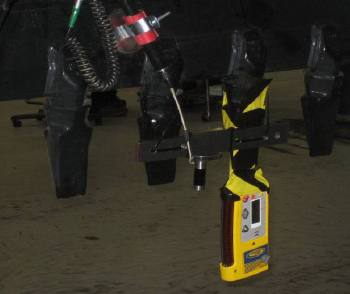

A single-point cylindrical sensor is mounted at the bucket tip, as shown in figure 5. The value measured by the sensor is translated to the BHL frame origin so as to be able to compare it to the bucket tip value calculated within the on-machine control module using forward kinematics. The bucket tip is moved to various locations in space and the static accuracy of the bucket tip is calculated at each location by measuring the difference between the calculated value and the measured value. If the bucket tip errors are outside the desired accuracy specification, then the calibration is repeated.
Figure 5: A cylindrical iGPS sensor is mounted between the third and fourth teeth of the bucket link. The center tooth tip or the bucket tip is at this location. The yellow receiver suspended by a tape is not part of the setup.

A cylindrical sensor is mounted at the bucket tip, as shown in figure 5. An interface shown in figure 6 was designed to capture the position of the sensor position in real time, along with the position of the bucket tip calculated by the onboard control module on the BHL. To compare the computed bucket tip value to that obtained from the iGPS sensor, it is critical that the data be collected at the same rate. A data rate of 25 Hertz was found to work well for a normal digging motion.
The data was collected as the bucket tip was being moved slightly above the ground in a plane parallel to it. The data collection was started when the bucket tip was the farthest from the machine. The boom and stick links are then moved smoothly in a normal digging motion, while the bucket tip is moving closer to the BHL frame. The bucket tip moves in a plane above the ground through the entire motion. The data collection is stopped when the bucket tip stops moving. This is repeated for multiple cycles and in different planes and orientations of the swing link. The average value gives an estimate of the accuracy with which we can locate the bucket tip of the BHL during a typical operation.
